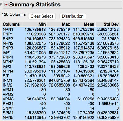

Cols> Column Viewer

Cols> Column Viewer

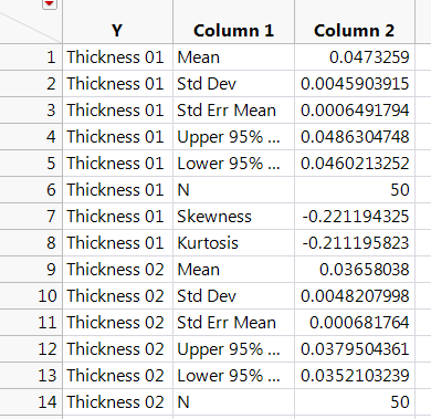

You won't get skewness and kurtosis from Column Viewer, but you can actually do essentially the same thing I suggested for the Column Viewer in Distribution (I should have pointed this out in my first reply, lol).  Right click in the summary statistics table and select "Make Combined Data Table".  You will get a table with summary statistics for each column you have plotted in Distribution.  At first, it will be in a long format like the screenshot below:CombinedTable.PNG

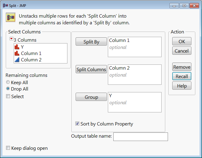

 It's probably better to have this in a wide format, so I would recommend splitting Column 2, split by Column 1, and grouped by Y.SplitDialog.PNG

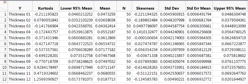

 Your final table will look something like this:SummaryTable.PNG

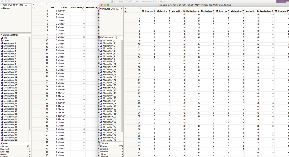

Since you have been so SUPER, I have another nagging question that you might be able to help  me: when I imputate a dataset, the new imputated table never has the original group with them (in this case, it is "Level"). In another word, only the numbers show in the imputated table. Is there a way to get the words to come as well? Now I just go back to the original table and copy that column. I wonder if there is a setting to adjust that. Screen Shot 2018-01-25 at 8.12.23 AM.png
Re: Quick way to extract descriptive statistics
What version of JMP are you using?  You shouldn't be getting a new data table output with Multivariate SVD or Multivariate Normal Imputation.

JMP Pro 13
I should have also asked how you are doing your imputation - what method are you using?  Not that it should be any different, but I see you are also using a Mac.  When I do either multivariate normal or multivariate SVD imputation on my Windows machine my original table is updated with the imputed values, no new table is created.

So i go to Analyze-Multivariate Method-Multivariate-Imputate. Thanks for helping, Bill!
