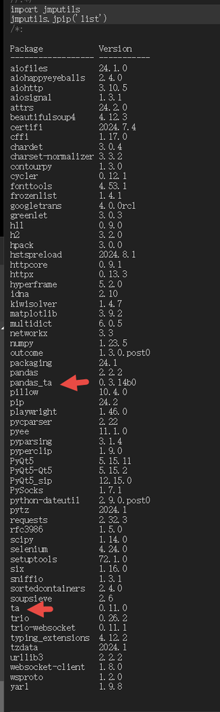

Is there a list of python library names in JMP18.0.0?
I know it is possible to see a list of installed python libraries for JMP
jmputils.jpip('list')
But I would like to know the list of uninstalled python libraries that JMP software already includes
For example I want JMP python to copy the result to the paste board and whether it wants to be installed
it can't
jmputils.jpip('install','pyperclip')
Thanks Experts!

I have seen these, but my ability to read English is limited, and have only tried the following similar methods, but none of them succeeded.
So I had to turn to the experts again.Thank you very much!
