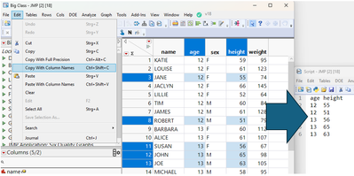

Hi everyone! I noticed that when using "Paste with column names" to copy multiple columns, selecting multiple columns in the left column window doesn't work. You actually have to select these columns directly in the data window to use it normally. But this makes it really inconvenient to operate, especially when there are a whole bunch of scattered columns. Is there a better way to copy multiple columns in batches? Thanks!

I'm not exactly sure what you are trying to do here.
If you select columns from the Column panel it will also select them from the data table
If you wish to copy the data to clipboard, you also have to select the rows you wish to copy and you have to do it after selecting the columns from the left. Otherwise, it will just copy the column names as that is the active selection.

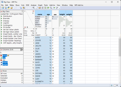

I think I understand the working mechanism you are explaining.
After selecting the column names in the column panel, the columns in the data panel will be in a light blue highlighted state. At this time, I need to click on the blank area above the row number list in the data panel to make the selected columns turn into a dark blue highlighted state. Only then can it be said that the columns and the data inside them have been selected.
Only when source and target columns all in dark blue state can these two commands be used to copy and paste data.

You can click anywhere in the data table.
Here you will have just columns selected and no data AND selection is active on column names

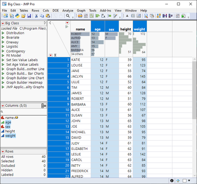

You can click anywhere on the table, but depending on where you click different selections will happen. Just make sure that the columns stay selected when you click on the table and figure out which option is best for you (blank space somewhere, row listing or holding ctrl and clicking on the table cells).
If you click on blank space, the selection will change from column names to column headers
I think you can copy at this stage but you can also select the rows you are interested in (ctrl+A to select all rows).

a) select all rows: CTRL+A
b) deselect all rows: click on the lower triangle (the blank area above the row number list)
