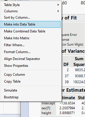

Just go to the report, right click into the Parameter Estimates menu and select make into data table.
The table can then be merged back into the source table ...

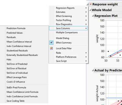

Alternatively, you could use Save column from the red triangle menu to save e.g. the prediction formula back to the source data table).
