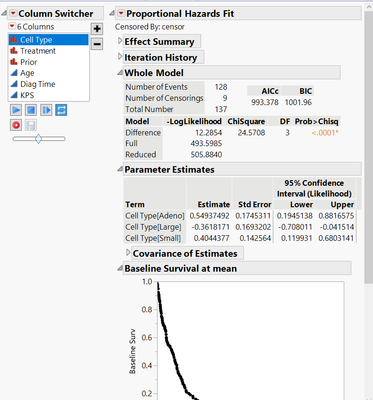

1. Fit the proportional hazards model and set the column switcher from the red triangle.
2. Write the following code in the scripting window and edit line 9 in the script.
