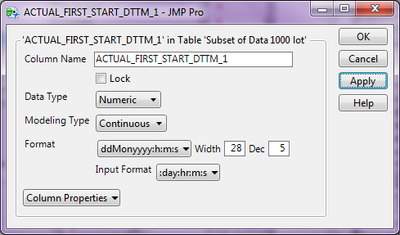

Concerning the displaying of inputted values that have data in milliseconds,  you can specify decimal places for the time formats

Thanks Jim: reformatting to use decimal places is just the trick for the data logger.  It is obvious now you point it out.  I am sure I will be able to work around the microseconds etc issue (after all, that is really an issue of units more than anything).

This formula snippet converts the string to a date time format via the Informat() function and then uses the decimal place field per txnelson
Informat(
	Left( :Time, Length( :Time ) - 4 ) || "." || Right( :Time, 3 ),
	"mm/dd/yyyy hh:mm:ss"
