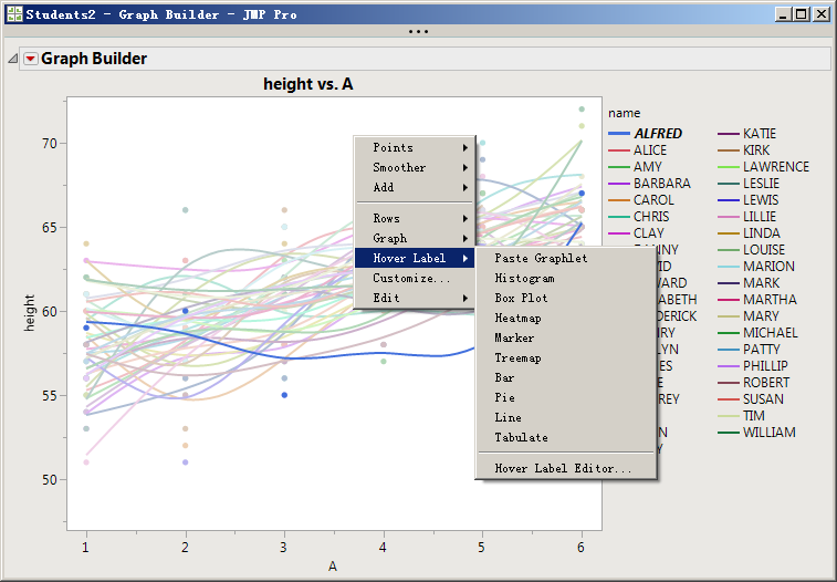

p1 = Graph Builder(
	Size( 528, 454 ),
	Show Control Panel( 0 ),
	Variables( X( :A ), Y( :height ), Overlay( :name ) ),
	Elements( Points( X, Y, Legend( 8 ) ), Smoother( X, Y, Legend( 9 ) ) )
Click any conditional curve in the graph, and automatically run the specified "D :\ A.jsl"

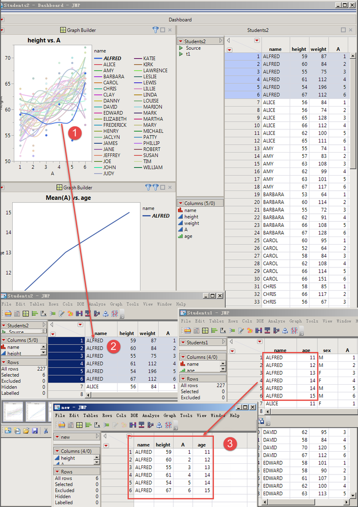

This "D:\A.JSL"、I mainly achieve the following functions:
Click on the selected curve to get the "name".Use this name to get the "age" of the name in another table"Students1.JMP".Create new table "new.jmp"
Draw the diagram as above.
Finally, the two graphs and each data table are used to generate a dashboard.

JMP has similar module function, can realize the following process operation:
by clicking the selected curve, get the "name".Use this name to get the age of the name in the other table students1.jmp.A new data table is generated with the selected name alone and the "height" in Table 2 and the "age" in Table 1.

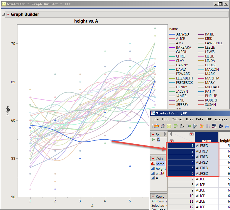

jthi
Re: Is it possible to execute a script by clicking a curve in the graph via JSL?
Maybe using Row State Handler on the original data table could work? Or if you can "skip" the clicking part then you could possibly use hover labels.

ian_jmp
Level X
Perhaps I'm missing some nuance of what's needed. But building on the suggestion from @jthi, you can do this kind of thing (where, once you have the current row selection 'doSomething' can be made to do whatever JSL is capable of):
