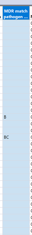

I have question about JMP , I have column with numbers (0) and letters so I need to create new column and using formula include only the letters and delete all (0) ! so is it possible to do that in JMP ? and which function I should use ?
I tried (word) function but it does not work with me!
Here the column :
and I want something like this :

If you just want to replace 0 with empty strings, you can use Substitute
Names Default To Here(1);
str = "00000000J";
Substitute(str, "0", "");
-Jarmo
