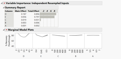

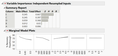

Thanks for the response. Just to clarify,  if I were to create models of how a set of inputs influences % recovery in two different systems, then it would not be possible to comment if one of those parameters in more important in one system than another? For example, I created independent models using inputs A-E trying to predict % recovery in two different systems using the Fit Model function and the Response Surface macro to account for interaction effects. Then, for the model for each system, the least significant effects (main, interaction, etc) were removed to optimize the R2. I also used the "Assess Variable Importance" function under Prediction Profiler and got the these tables.
System 1:
System 2:
Would it be accurate to say that Variable D has a more important effect in predicting the %recovery in System 1 than in System 2 because the “Total Effect” is larger in System 1 than in System 2?
