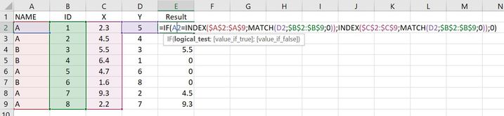

Is it possible in JMP to re-create the "INDEX(MATCH()) formula combination available in Excel?
This is the table I am working on:
In the column “Result” I want to put a particular value which respond to this rule:
  • If (“Y” is not 0) Return the “X” value contained in the cell with the same “NAME” as the current cell and with “ID” equal to the index indicated in “Y” (in this case 5).
  • Basically in the first row I want that “Result” contains “4.7”
@txnelson  you are the JMP wizard :) Do you believe it is possible?
Cheers

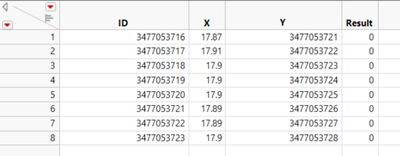

Hi All, i need expert advise on it. Currently i working on Index Match with using the same method / formula that you guys provided. I got return value of "0".
My data as shown below. Hope someone can help me on this.
* ID & Y column data from time converted to seconds.
Formula:
curY = :Y;
theResult = 0;
If( :Y != 0,
	theRows = Current Data Table() << get rows where( :ID == curY );
	If( Is Missing( theRows ) != 1,
		theResult = :X[theRows]
	theResult = 0
theResult;
Thanks!

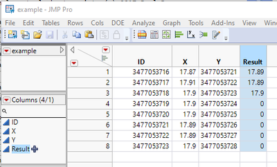

txnelson
Re: Is it possible in JMP to re-create the "INDEX(MATCH()) formula combination available in Excel?
The results I get when running against your Example data table, using your supplied formula is:
I have attached the Example data table, with the formula applied
Jim

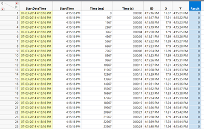

I had tried another set data which with date in the column ID and Y (Y with formula 1st cell add 5sec of start time and subsequent cell increment of 1second) as below. But I still getting "0" for result column. I need your advice on it. I'm appreciate of your help and guide. Attached with my example. Thanks and appreciate!
txnelson

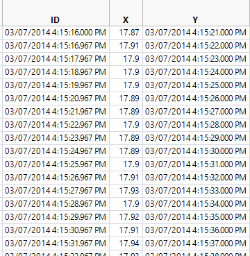

If you do a full display of the ID and Y columns in your supplied data table, you will see that except for the 1st row, all of the subsequent rows have a decimal value of .967.
The Y column has no such decimal value, so the values between them will never match.  I believe that you need to determine if the .967 needs to be rounded up, or removed, and then perform that operation to adjust your data, and then create the formula column.
Jim
dexue
Level II
Great ,Thanks Jim! It works after I rounded up column "ID". Finally i got what I want.

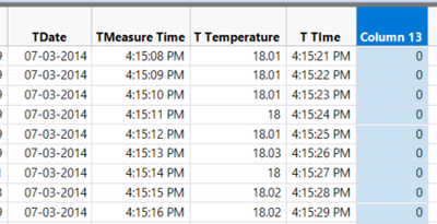

I tried to copy another set of data which included measurement value (T Temperature) and date (TDate), time (T Measure Time) from Text file to excel file and to the JMP data table, Column 13 (Result) shown failed. I checked the numeric number (T time vs TMeasure Time) which different. Do you have any idea on this? Thanks and appreciate for your guidance!
txnelson
You are indicating the data are coming in from Excel.  What method are you using to get the data from Excel to JMP? Problems can come from the way Excel saves values and also from JMP dealing with Excel.
I am not an Excel expert, but if you can provide the steps you are taking from text to Excel to JMP and how you are performing those steps, and maybe even samples of the text, Excel and JMP files, the Discussion Community members maybe able to help.
Jim

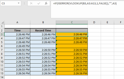

Would like to ask, how to come out with the formula in JMP that using Excel formula =IF(ISERROR(VLOOKUP(B3,A3:A13,1,FALSE)),"",A3)
Example as below. Appreciate and thanks!
txnelson
An exact match for your VLOOKUP would be
Try( (Current Data Table() << get rows where( If(Row()<=13,:Time,.) == :Record Time[1] ))[1], :Time[1] );
However, what I believe you want, is to handle each row, the formula would be
Try( (Current Data Table() << get rows where( :Time == :Record Time[Row()] ))[1], :Time[Row()] );
