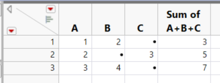

In this example, ;"Sum of A+B+C" calculates sum of :A + :B + :C in each row with this formula:
If( Is Missing( :A ), 0, :A ) + If( Is Missing( :B ), 0, :B ) + If( Is Missing( :C ), 0, :C )
If I change the specific column names to with column number, the script is not working anymore and generates an error
If( Is Missing( Column( 1 ) ), 0, Column( 1 ) ) + If( Is Missing( Column( 2 ) ), 0, Column( 2 ) ) + If( Is Missing( Column( 3 ) ), 0, Column( 3 ) )
What am I missing here?

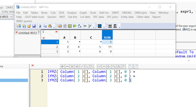

Put a [] at the end of your Column() functions:
Jordan
Craige_Hales
Re: Is Missing command- Scrippting
The empty square brackets tell JMP to index the current row of the column. Using [row()] is the same idea. Without them, the data type is a column, not a number, and isMissing requires a numeric argument.
