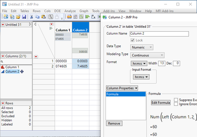

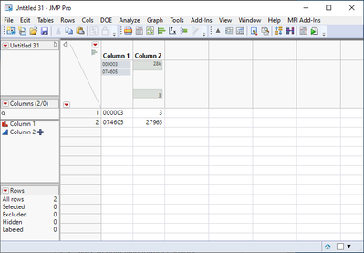

If I understand the "original" format correctly, one option would be to first convert first column to seconds by using formula like:
Num(Left(:Column 1, 2))*60*60 + Num(Substr(Column 1, 3, 2))*60 + Num(Right(Column 1,2));
and then convert that to duration format

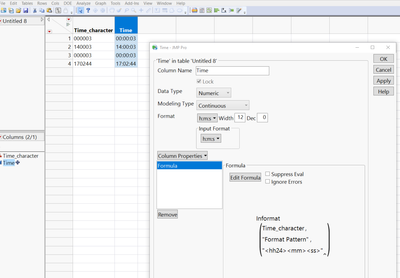

Another possibility is using informat:
Georg
Re: how to change a series of numbers into time format
 This totally solved the issue.
