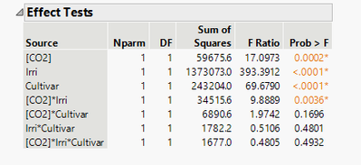

I performed a three-way anova to see the effects of factors(CO2, irrigation and cultivar) on the wheat grain numbers.

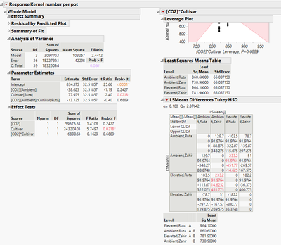

Effects shown that the interaction of CO2 and Cultivar was not significant(p>0.05), but the Tukey test seems there is the interaction between them.
When I look into the interaction of CO2 and irrigation, they  looks similar to the interaction of CO2 and cultivar, but the effects test of which was actually significant.
I did not understand why the multiple comparison show there is interaction but the effect test tells me no.

You can get different answers because these tests are asking two different questions. The effect test is asking if the term, as a whole, changes the model significantly when it is added along with the other terms. It is based on the sum of squares associated with adding the term. There might not be sufficient evidence (mean square) to indicate a significant term (F ratio). The Tukey test, on the other hand, is asking about differences between in the least squares means of combinations of factor levels. So it is possible that the test for the whole term is not significant but differences between some combinations of factor levels are significant. They often agree, but there is actually no requirement that they should.

When doing a 2-way ANOVA (not considering irrigation effect), I see that the interaction effect of the above is not significant, likewise a turkey test on the interaction term. I can't possibly understand why we have a difference when doing the 3-way ANOVA (as above). In such a situation where I need to consider all terms (main factors), what do I or rather how do I represent such discrepancy. Can you help with guidance here?
