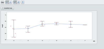

I am able to create an interactive HTML using "save Interactive HTML". However, when I add a filter, it does not create the filter in the HTML, just gives me the plot. Is there something I am missing?
My sample code:
Names Default To Here( 1 );
a = Variability Chart(
	Y( :height ),
	X( :age ),
	Analysis Type( "Choose best analysis (EMS REML Bayesian)" ),
	Connect Cell Means( 1 ),
	Std Dev Chart( 0 ),
	Points Jittered( 1 ),
	AIAG Labels( 0 ),
	SendToReport(
		Dispatch( {}, "Variability Gauge", OutlineBox, {Set Title( "VariabilityChart" )} ),
		Dispatch( {}, "Variability Chart for height", OutlineBox, {Set Title( "" )} ),
		Dispatch( {"Variability Chart for height"}, "Variability Chart", FrameBox, {Frame Size( 845, 274 )} )
	Local Data Filter(
		Add Filter( columns( :Name( "SEX" ) ), Display( :Name( "SEX" ), Size( 278, 165 ), List Display ) )
a << Save Interactive HTML( path || "Filter.html" );

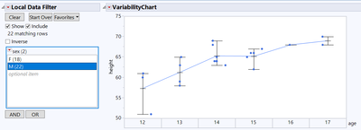

This is what I want
This is what I get

The problem is that putting a filter into the HTML, and making it work would require the html to recalculate the data for the graph. If you happened to have JMP Live, then you could publish this figure to the JMP Live server, and then when you change the filter, an instance of JMP on the Live server would do this for you.
kind of like this:
Example HTML figure with a filter
Another approach is to make tabs with each level of the filter
kind of like this:
figure with tab boxes
       note: the tab boxes are over the run chart at the bottom of the "dashboard".

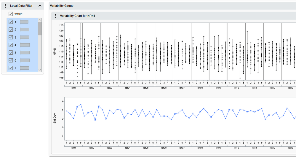

If I run this script
dt = Open( "$SAMPLE_DATA/semiconductor capability.jmp" );
		vc = dt << Variability Chart(
			Y( :NPN1 ),
			X( :lot_id, :SITE ),
			Local Data Filter(
				Add Filter( columns( :wafer ), Display( :wafer, Size( 161, 255 ), Height( 255 ) ) )
and then interactively go to
     File=>Save As
and save the file as an Interactive HTML With Data, or if one goes to
     File=> Export=> HTML with Data
I get the following HTML
But I can not find a JSL function that can do the same.
