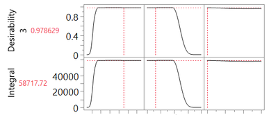

Integrate( :Desirability 3, :"x"n, 35000, 95000 )
Afterwards I plotted both, the original desirability function and the integral function. However, both functions show the same profile in the profiler.

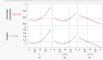

I thought it might be easier to illustrate the problem with a real example. Therefore I have created a JMP file (attached) where I have a polynomial model y which is afunction of x1, x2 and x3. I have created a desirability function and replaced "y" with the model equation (analog to the comment)
@hogi wrote:
To get an equation depending on your input values f(x,y,z), you have to replace this Symbol with the prediction equation - i.e. the column formula of the Disso column.
From there I used the integrate function, to integrate x1 from -1 to +1.
I got the same result as before, the profile from the desirability function and the integral are identical.

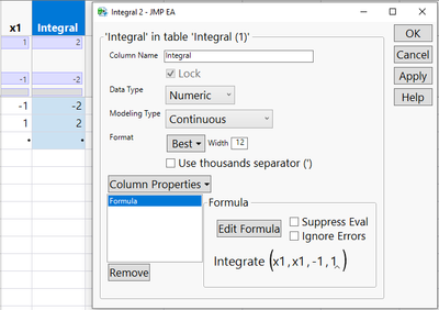

Regarding integral in general - according to the scripting index, the second argument should be a variable.
So I was wondering if it is at all possible to put a column name there:
Integrate(:x1, :x1, -1, 1)
Not really: Jmp first replaces x1 in the first argument with the entry of column :x1 - and then uses this constant numeric value for Integrate, so
Integrate(:x1,:x1,-1,1) = :x1 * Integrate(1,:x1,-1,1)= 2 :x1
[along this line: If there is no value in column :x1, the result is undefined.]
Same finding for the profiler:
- Jmp provides a slider for :x1 - despite the Integral.
- the result is not 0, but     2 x1
This fits to your findings: Integral = 2 x Expanded Desirability.

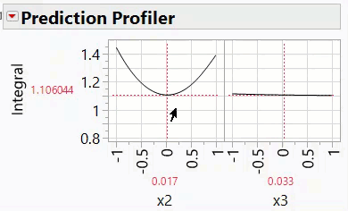

As a solution, let's follow the scripting index and use a variable (z):
If you generate a profiler plot for Integral, Jmp just displays sliders for x2 and x3 and calculates the integral over z (old :x1):
