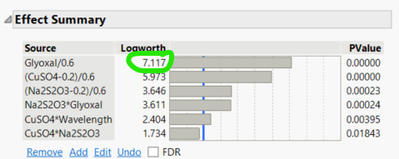

Logworth:

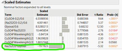

Scaled Estimates:
You can see that in the first image, the one with the highest Logworth is "Glyoxal" and I would think this is the more impactful effect. However, if we look at the "scaled Estimates" in the second picture, it is rather the interaction  Na2S2O3*Glyoxal that seems to have more impact.

You are comparing two different and complementary informations, statistical and practical significance.
Statistical significance refers to the likelihood that an observed result or relationship between variables occurred by chance. In other words, it is a measure of how confident we can be that a relationship exists between two or more variables. In statistical analysis, this is typically assessed using a p-value (or logWorth, which is just calculated using -log transformation of the corresponding p-value), which is the probability of obtaining a result at least as extreme as the one observed, given that the null hypothesis (i.e., the hypothesis that there is no relationship between the variables) is true. If the p-value is below a certain threshold (e.g., 0.01, 0.05, or 0.1), the result is considered statistically significant, indicating that the observed relationship is unlikely to have occurred by chance and that the null hypothesis can be rejected. In the context of mixtures like in your example, traditional model selection techniques using p-values are not useful : due to multicollinearity between estimated effects (aliases between effects), standard errors of the estimates are quite large, resulting in misleading and distorted p-values. More infos in this discussion : https://community.jmp.com/t5/Discussions/Analysis-of-a-Mixture-DOE-with-stepwise-regression/m-p/6570...
Practical significance refers to the real-world importance or relevance of a statistical result. It is concerned with whether or not the observed relationship has any practical or meaningful implications. The practical significance is indicated by the size of the estimates : the bigger (in absolute value) for a term, the more important and the more influence has this term in the regression model of the response considered.
Note that statistical and practical significance may not always be closely related : a result can be statistically significant but practically insignificant, or the opposite situation. It is important to consider both significances when interpreting results.
