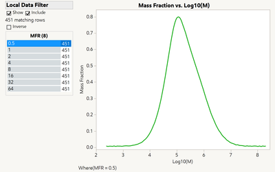

Just so happens that I am trying to do the same thing.
FDE course > Capstone Study > Polymer Development example (attached below). I have molecular weight distribution data just like that. I want to know how much of the mass has MW > 10^6. Since I don't have a function, I need the numeric integral to answer the question. Is there some existing JMP platform that can do this? Or is it time to break out my numerical methods textbook and write some formulae...?

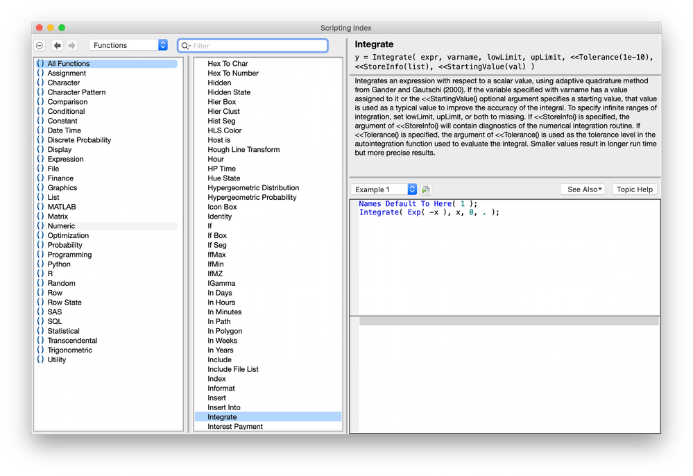

Perhaps you won't have the 'crack open' that text book after all.

Thanks! Integrate() takes an expression as argument, f(x). I don't have an expression, just raw (x,y) data. I don't want to fit a smooth curve to it since I am really interested in the bumps in the distributions.
Re: How can I calculate area under the curve in jmp pro?
I think that you have to resort to a summation. The Summation() function is useful for this purpose. It should work with rows in the data table or rows in a matrix. I can't think of anything else.
