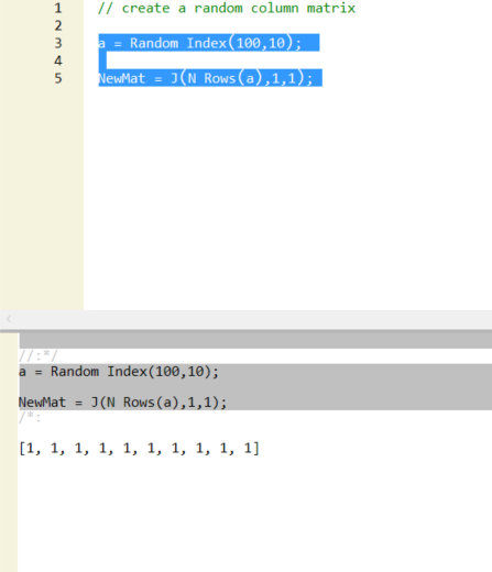

a = Random Index(100,10);
NewMat = J(N Rows(a),1,1);  // Use the J() to do this
The above sample worked for me
