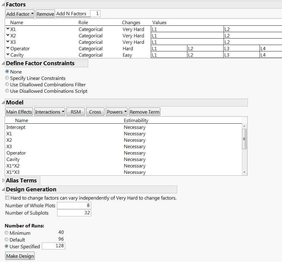

There's a couple ways to approach this.  If you want to use Custom Design, you can do that by specifying a split-split plot structure with your 3 2-level factors as "Very Hard" to change, Operator as "Hard" to change, and Cavity as "Easy."  Model should probably contain all 2-way interactions.  You would then specify 8 whole plots, and 32 subplots, and 128 total runs (you'll need to cross this design with your 3 repeat measures from each cavity to get your 384 total data points).  Your design dialog should look something like this:

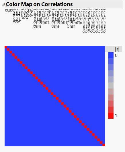

I was able to get the full factorial for the 128 runs with the default settings, but you can increase the number of random starts or design search time if that doesn't work out for you the first time.  You can tell if you got it if the Correlation Map looks like this:

I attached my result using this method.
