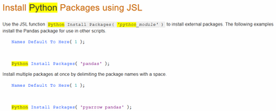

I was following the instructions in the online help to install python packages (pandas, numpy, ...) that I need for my scripts, but I am having trouble.
When I run
Names Default To Here( 1 );
Python Install Packages( "pandas" );
(I needed to change to "" for it to work), I'm getting the error:
import jmputils
jmputils.jpip('install', 'pandas')
ERROR: Can not perform a '--user' install. User site-packages are disabled for this Python.

Yes, the JSL should use double quotes for the string instead of the single quotes.  Not sure how that got past our automated tests.

Then you perhaps should change it in the online help ;) I was a bit stumped when a simple copy+paste threw errors until I changed the quotes.

Was this online support or the scripting index or both?  It is something that needs to be fixed in the documentation.

Only in the online support. I didn' t look in the scripting index.
