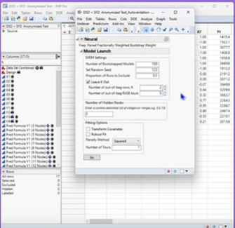

There is a very interesting presentation by Phil Ramsay on SVEM for analysis and modeling DOE results: he uses a Predictum shown here below, how can I install this?

Predictum is a separate company that provides services and addon's for JMP software. I did not see an offering in the JMP File Exchange area or in the Market Place for what you are showing, so I am assuming you need to go to Predictum directly.

If you're interested about the validation method behind SVEM and its use for various modeling platforms, you can use autovalidation table or use the SVEM add-in, as explained in my answer to one of your previous post SVEM ADD IN FOR SUPPORT VECTOR MACHINE SVEM (Forward Selection) is also one of the default estimation method available in the Generalized Regression platform.
Besides these (free) options, the add-on shown in your capture is a product you can buy from Predictum, as mentioned by @txnelson : https://predictum.com/products/svem

Will it in JMP 19 (or next versions) be possible to use SVEM in ML model launch like e.g. below in Neural Network (Demo Phil Ramsey)?
Very interesting figures to find the best model with a test set. Great predictum tool!
