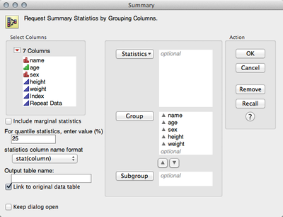

I usually use Tables->Summary to get a data table free of duplicates. Just Group by all of the columns that would define a duplicate. This has the added advantage of providing a column (N Rows) that tells you how many duplicate rows there were in the original table.
-Jeff
