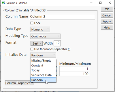

Hi, the initialize data settings in the column menu are quite useful.
Who managed to control the settings via JSL?
In the scripting index, I just found:
which fits to "constant" mode. How can I set the other modes?

Only constant and today are specifically using initial data, rest are building them using for each row (JMP action recorder seems to be recording actions for Constant and Today data initialization incorrectly).

Re: Initialize data - very useful - but fragile!
Ah right, good point. Surprising ...
Today() is really (!!!) useful.
Every new row is added with the current timestamp -  some hidden "magic" which is not visible from the script for the data table.
A pity that Sequence Data and Random are just accessible in the beginning - no chance to trigger them later:
And when a user changes the setting to
Missing/Empty or misses the chance to define a  Initialize Date setting before he writes the first value into the column - he loses his chance to see the menu.
So, some things that could be improved in a future version of JMP ...
On the other hand, I don't know id other JMP users use this feature
- and how many of them feel limited by the current functionality.

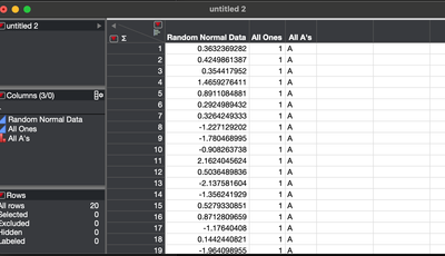

When I use JSL to create columns and specify values for those columns, I tend to be very specific and do things like
dt=New Table();
c=dt<<New Column("Random Normal Data");
dt << Add Rows(20);
c << Set Values(J(nrows(dt), 1, Random Normal()));
c=dt << New Column("All Ones");
c << set values(J(nrows(dt), 1));
dt << New Column("All A's", Character);
for each row(
	:"All A's"n = "A"
