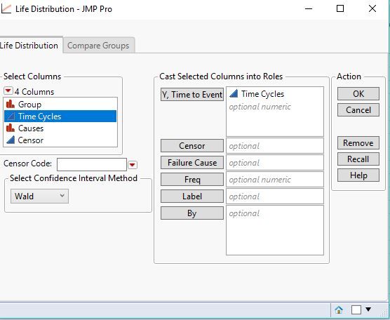

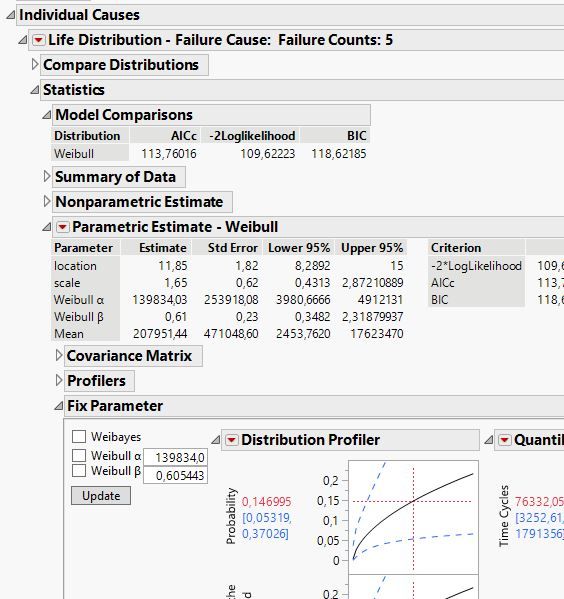

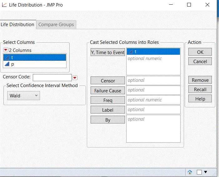

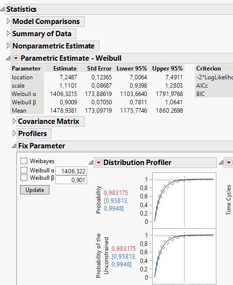

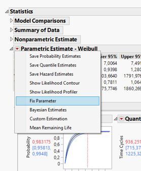

You have to select weibull from the compare distributions panel, then in the statistics section under Weibull the hotspot and select Fix Parameter (2nd picture). The 3rd picture shows the appearing report where you can set weibull alpha and beta.
2. With Failure information to see distributions for each failure cause.

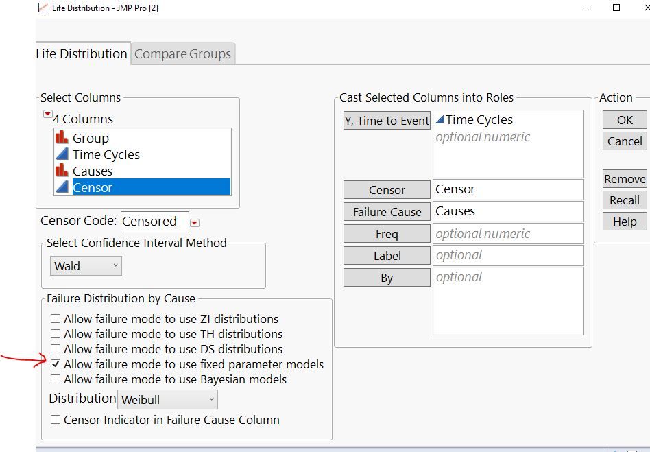

If you want to be able to fix the parameters in the individual failure cause distributions you have to set this optin already in the launch window (above picture). then you select weibull in the compare distribution panel, go to individual distributions of one of the failure causes and select there the Fix Parameter similar to the first option:Capture1.JPG

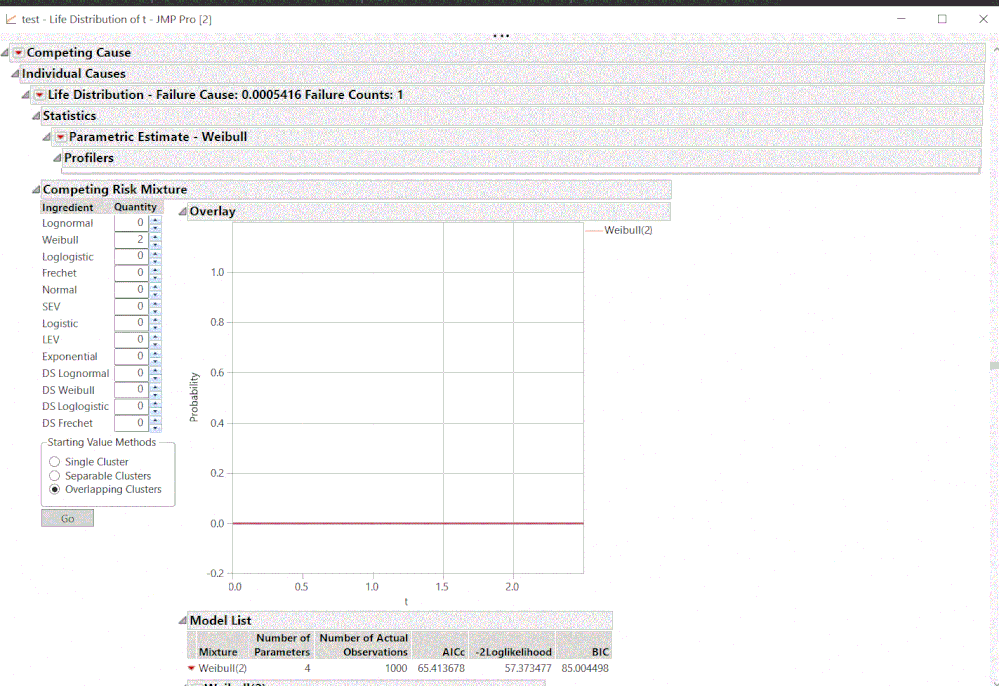

3. Competing Risk Mixture Option:
Heree you will not ahave the option to specify Fix Parameter for the weibull as it tries to find the weibull parameters depending on the mixture of the distributions you set in advance.

When you use the competing causes in the life distribution platform you need to specify the setting upfront in the launch window:
Then you can in the individual weibull fits fix the parameter settings as well. The fix parameter option will not appear if you have not checked that box in the launch window or set it in the preferences of this platform.

Ok, I tried those steps using JMP Pro 15, but it seems that I'm still not able to change the parameters in the below image? Thank you so much for your help for your previous posts! I really appreciate it.

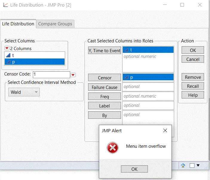

I tried to do that in the below picture using JMP Pro15, but the "failure distribution by cause menu" doesn't show up. I tried doing it without using the censored function, and the same thing occurs. I tried doing it with the censor function, and clicking the red triangle in the censor code place, but another window pops up saying "menu item overflow". (I would think it shouldn't matter whether the data is censored or not?) Am I missing something? Thanks!

Maybe my previous post was confusing and not exactly to what you were asking for. The failure cause is not necessary (just added it as you mentioned different competing risk scenarios and thought you meant to understand the risk involved with different failure causes - my fault not reading accurately ;) ).
You can launch the life distribution platform without censor or without failure cause or without both. In each case you have the option to fix parameters after you have done the weibull fit using the red hotspot of the then created outline box for the Weibull analysis.

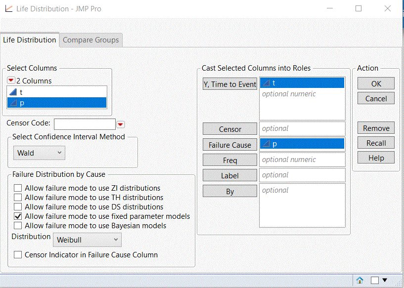

From what I'm understanding so far and with playing around with the JMP Pro 15, if I want to set intial conditions for the competing Weibull function, I need to do it beforehand in the "Life Distribution" Window. If I put something in the "failure cause" section, the "allow failure mode to use fixed parameter models" shows up, as in the below picture.
If I don't put something in the "failure cause" column, then the "allow failure mode to use fixed parameter models" doesn't show up, as in the below picture. If I don't know the failure cause, then does that mean that it's not possible to change the initial conditions?
