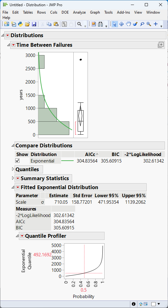

You can fit your data using the exponential distribution in the Distribution platform. Use the Quantiles command in the red triangle menu of Fitted Exponential and specify 0.005, 0.5, and 0.995 for the desired probabilities. The estimated quantiles can then be used for user-specified control limits. Right-click in the Individuals chart in CCB and select Limits > Add Limits. Enter the quantiles here.

Note: The Quantiles command was replaced with a Quantile Profiler in JMP 18. Otherwise, the process is the same.

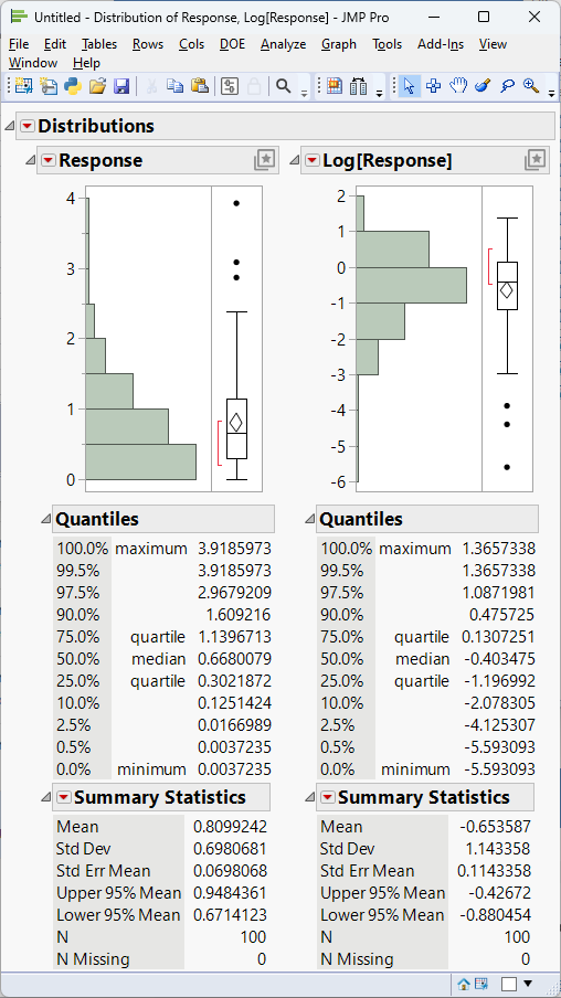

Here is a simulated sample of data from the exponential distribution, Response, and transformed Log[Response] data.

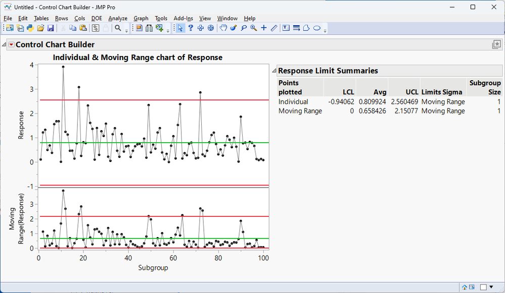

Here are the XmR charts for Response using Control Chart Builder.

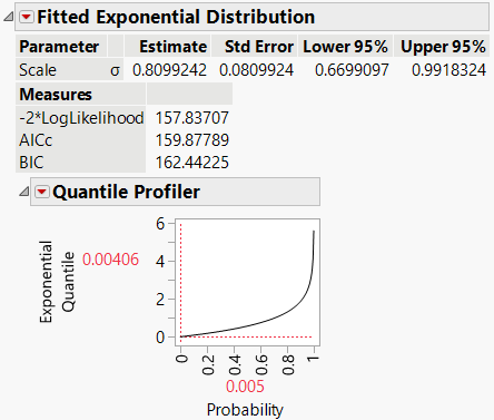

We want to use probability limits based on the quantiles corresponding to 0.005, 0.5, and 0.995 for the desired probabilities. Here is the distribution analysis of both responses.
Here is the fitted exponential distribution model for Response with the Quantile Profiler turned on and set to probability = 0.005.
We will use 0.00406 as the lower control limit. Using this profiler, we can similarly find the other two quantiles.

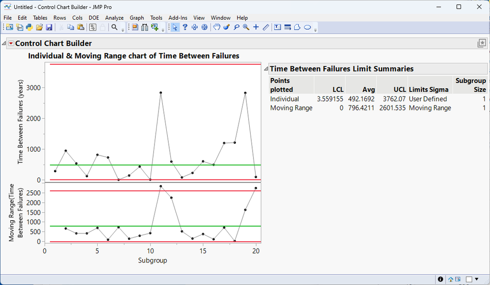

Return to the CCB, right-click on the Individuals chart, and select Limits > Set Control Limits. Enter the three quantiles determined above.
The CCB immediately updates with the appropriate control limits.

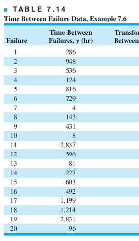

In the meantime, see this from the Montgomery’s book
