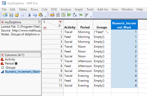

Could you demonstrate one approach on the JMP dataset "Dolphins" please (excerpt below)?

For the "Dolphins" levels Morning, Noon, Afternoon, Evening I'd expect the increments 1,2,3 resp. 4 (subject to sorting order)

Here is the formula for the Numeric_Increment_Want column
If( Row() == 1,
	Summarize( myGroups = by( :Period ) )
Contains( myGroups, :Period );
I had to change the previous code because the reference to "Groups" in the old code, conflicts with the Dolphins data table having a column named Groups.  So I changed the variable name to myGroups.
Attached is the data table with the new column added
Jim

I cannot explain why it now works. I also adjusted for "Groups". Weired. Anyway, I solved it like that and it works like a charm. Jim, thank you very much. Again!
