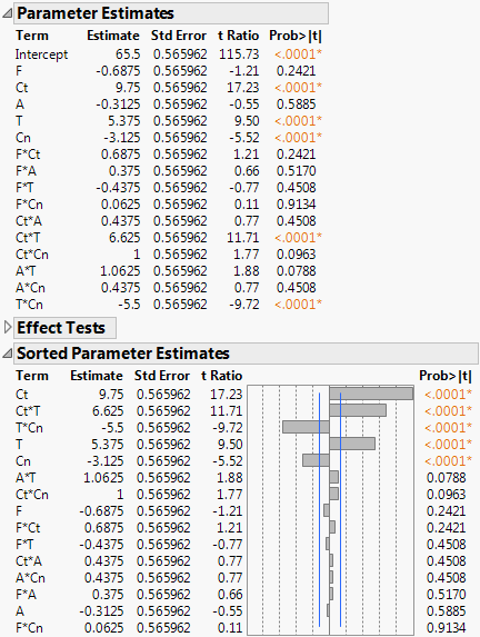

Regarding the parameters of the fitting of the model, I'm interested in determining the critical t value for my significance level, i.e., the value of the blue vertical lines in the Sorted Parameter Estimates (example below). Is there a way to calculate this value?

Use this built-in function: t quantile( probabilty, DFE). The blue lines indicate 95% significance, so use 0.025 or 0.975 for the probability.

Re: Critical Values in Sorted Parameter Estimates
