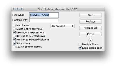

Since you have those leading zeros in your data that column must already be set as character, I'm assuming because you are storing letters as well as numbers. To eliminate those zeros in place you could use regular expressions in Edit > Search > Find.  Regular expression are quite powerful but aren't so friendly to look at. For your situation, the following regular expression will search out leading zeros but will not find zeros that are inside the string:
(?<!\d)0+(?=\d+)
To use this, paste the regular expression in the "Find" section, leave the replace section blank, and check the box for "use regular expressions." I would also check the box for "restrict to selected columns (and make sure you have selected your column of interest). With everything set up, you can now click "replace all" and JMP will find those leading zeros and replace them with blanks. I've also attached a screenshot of this setup below.
(?<!\d)0+(?=\d+)

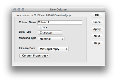

1. Make a new column by going to Cols menu > New Column.
7081_Screen Shot 2014-07-30 at 10.36.24 AM.png7081_Screen Shot 2014-07-30 at 10.36.24 AM.png
2. For the data type, select "Character." This is necessary if you wish to have leading zeros and characters (numeric columns will ignore leading zeros as they have no meaning for actual numbers, and can't store letters). Once you do this, click OK

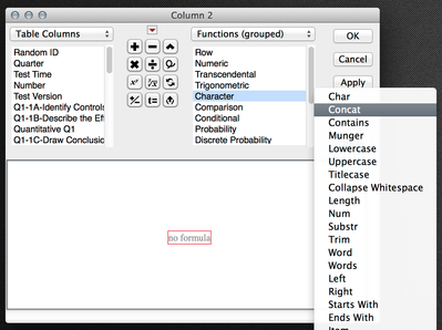

4. This is the formula editor. Here, you can define a formula that will apply to the entire column. What we want is a formula that will prepend a zero (or any characters you want) to your existing values in the original column. We can accomplish this with a character function called "concatenate." Here are the steps to set up that formula:
    a. In the upper right section (the function group list) select "Character" and then select "Concat"
7082_Screen Shot 2014-07-30 at 10.36.56 AM.png7082_Screen Shot 2014-07-30 at 10.36.56 AM.png

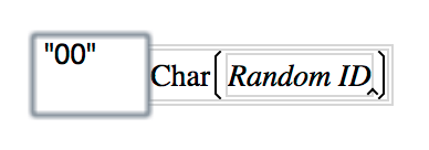

    e. Next we need to decide what we are prepending. Double click the first rectangle, which will open the editor for that field. Here we want to prepend the MOST number of zeros we will need. For the example I used above, we would prepend with two zeros. Enter (with the quotes) "00" and then hit the enter or return key.  Here is what that would look like before we click enter:
7086_Screen Shot 2014-07-30 at 10.45.39 AM.png7086_Screen Shot 2014-07-30 at 10.45.39 AM.png
