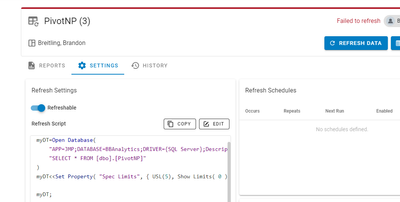

I have created a control chart that I would like to be refreshable. I added the "open database()" code and the refresh worked fine but didnt save the spec limits. I tried to change the refresh script JMP Live window to add the spec limits but that doesn't work with the code below. Any help for how to do this? Need the spec limits for the chart and the capability analysis in JMP Live.
<Open Database(
	"APP=JMP;DATABASE=BBAnalytics;DRIVER={SQL Server};Description=BB Analytics Data Warehouse;Trusted_Connection=Yes;WSID=SFX-BVH62Z2;SERVER=SFX-DWA01;DBCNAME=SFX-DWA01;",
	"SELECT * FROM [dbo].[PivotNP]"
// Change column property: ASH
Data Table( "PivotNP" ):ASH << Set Property(
	"Spec Limits",
	{USL( 5 ), Show Limits( 0 )}

One thing I might try would be:
myDT = Open Database("APP...", "Select...");
myDT << Set Property( "Spec Limits", { USL(5), Show Limits( 0 )});
myDT;
But I'll come up with a working example.

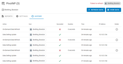

Below is the error in the history tab:
Error refreshing data for package Hm28VHvPrvTrDmXCDZclR in JMP session Jm_6hQLy4Sl7fJh9cSSvm. An error occurred while running the data table refresh script: Unexpected "myDT". Perhaps there is a missing ";" or ",". Unexpected "myDT". Perhaps there is a missing ";" or ",".Line 5 Column 1: myDT<
Here's the history tab showing that it works some of the time (when i just include open database()

K, reading the error log that first myDT statement didn't end with ; so now that it does it works! Thanks so much for the help! I have a list of spec limits so if there is a way to generate that... I'll figure it out but if you already know you could post that.
