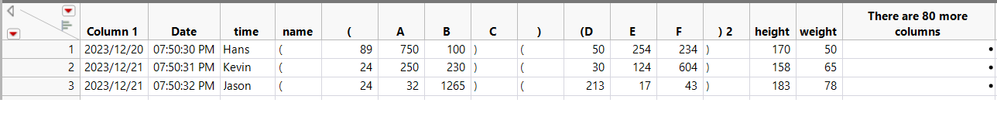

I'm trying to import multiple CSV files, the "import multiple files" function doesn't work well because original data column name format has two problems that will cause title and data don't match
1. The data column name looks like this:       Date time name ( A B C ) (D E F ) height weight ......etc
2. The dilim I need are space and ( and )
3. However, there is additional space or tab before "Date", so the first column name becomes Column 1 rather than Date, and title right shift one column compare to data
4. second error is (D, there in no space between this two for the title, so they are treated as one title, but the data are separated into ( and D two columns because there is space in between, so title will left shift one column compare to data
5. The first error always exist before first column name "Date", but the second error "(D" may appear at different order based on source tool
I would like to wirte a JSL so that it can automatically match all title and columns, but not sure how to do this:
I guess the first step is to use  Get Column Names() then parse the names, but parse() and word() seems don't work.
I' m stucked here, really raw at coding, thank you for your help in advance

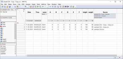

Don't create one massive string, but rather create data tables one by one and concatenate those as you go. Also when posting JSL scripts please use "Insert JSL Script" jthi_0-1703167167340.png as it makes it much easier to read.
Names Default To Here(1);
dir = "$DOWNLOADS/New Folder (7)";
filelist = Files In Directory(dir);
mylist = {};
dt_collector = Empty();
For(i = 1, i <= N Items(filelist), i++,
	file = dir || "/" || filelist[i];
	str = Load Text File(file);
	lines = Words(str, "\!N");
	data = Transform Each({line}, lines,
		line = Collapse Whitespace(Substitute(line, {"(", ")"}, ""))
	modifiedstr = Concat Items(data, "\!N");
	dt = Open(
		Char To Blob(modifiedstr),
		Import Settings(
			End Of Line(CRLF, CR, LF),
			End Of Field(Spaces, Space, CSV(0)),
			Strip Quotes(1),
			Use Apostrophe as Quotation Mark(0),
			Use Regional Settings(0),
			Treat empty columns as numeric(0),
			Compress Numeric Columns(0),
			Compress Character Columns(0),
			Compress Allow List Check(0),
			Labels(1),
			Column Names Start(1),
			First Named Column(1),
			Data Starts(2),
			Lines To Read("All"),
			Year Rule("20xx")
		invisible
	dt << Set Name(filelist[i]);
	dt << New Column("Source", Character, Nominal, << Set Each Value((dt << get name)));
	If(!Is Empty(dt_collector),
		dt_collector << Concatenate(
			dt,
			Append to first table
		Close(dt, no save);
		dt_collector = dt;
-Jarmo
