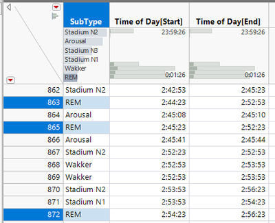

🙋‍:female_sign:Hi!
Within the column "Subtype", I need to count the number of times "Stadium N2" appears between 2 occurences of the word "REM", only when the time in column "Start" of the second REM occurence is within 15 minutes of the time in column "End" of the first REM occurence.
See stars in screenshot: in this case, the count would be 3
What is the formula to do so?

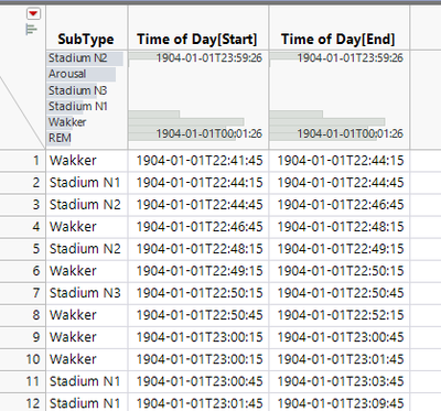

How should the data be ordered for that? For example here we have first REM ending before next ends?
Or is the data already correctly ordered (I just changed the format here to be date time)? We are missing date information so how can be differentiate when day is changing or should we guess it based on the timestamps?
Edit: Going with the original order of data and only caring about checking end and next start
