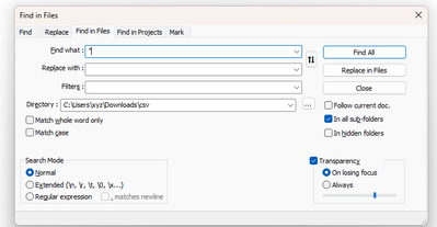

Another solution: use "Notepad ++" / Replace in Files:
 to get rid of the quotation marks.

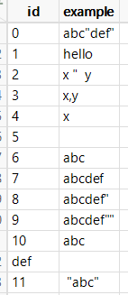

 for more fun with MFI and CSV quotes
use the attached file
input:                                                                                                 JMP:
Once a hypothesis has been set up that fits rows 1–N, it is easy to find a black swan for row N+1 ...
hogi
Level XIII
Re: Import multible CSV files in a folder and stack them
0. if there are characters in fron of the quotation mark, its no CSV quote.
  1. if the first character of the cell is quotation mark, it's a CSV quote -> scan to find the closing quotation mark
  2. if on your way there are two adjacent quotation marks, treat them as a single quotation mark
  3. if on your way you find a comma, it's a comma
  4. if on your way you find a newline, it's a newline (!!)
    actually, the content of the cell is:
  5. any other interesting characters?  ...
  6. if you find a closing quotation mark, the quote is complete
  7. search for a delimiter or a line break.
    any character you find: just add it to the quote.
  8. here: a single quotation mark is a singe quotation mark
  9.          2 quotation marks are 2 quotation marks (compare #2)
  10. if you find a delimiter or line break, this is the end of the cell (compare #4)
  11. With a space in front of the quote, the quote is no CSV quote.
    (subset of  #0)
    It took me a while to understand
    from the previous post, this is why I added it as a separate case.

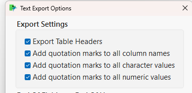

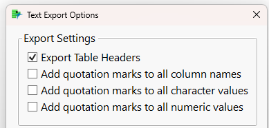

in JMP, we can disable the options:
hogi_3-1756502818871.png]
Unfortunately, the CSV encoding is enabled by default. On the one hand, it's reasonable — saving the file without CSV quotes would change the data structure significantly!
