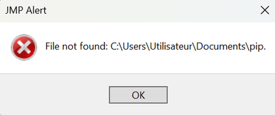

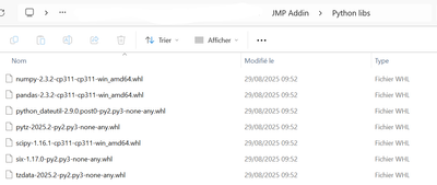

Currently I have done the following:
strPathPythonLibs =  "C:\Users\Utilisateur\Documents\Sophie\JMP Addin\Python libs";
Python send(strPathPythonLibs);
Python submit( "
import sys, subprocess
subprocess.check_call([
    sys.executable, '-m', 'pip', 'install',
    '--no-index',
    f'--find-links={strPathPythonLibs}',
    'numpy', 'pandas', 'scipy'
Do you know how to resolve the issue ? I know that the sys.executable should return the path of JMP python.exe but for some reason it returns the path of jmp.exe. Where is the  python.exe used by JMP?
