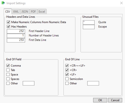

I am using 'Multiple File import' function to import .CSV to JMP. My data start at raw 253. In .CSV timestamp is in cell C111. How can I modify below script to also import time information?
You could export the data twice, once for data and once for timestamps. Then join them together, just remember to include file names if you are importing multiple files.
