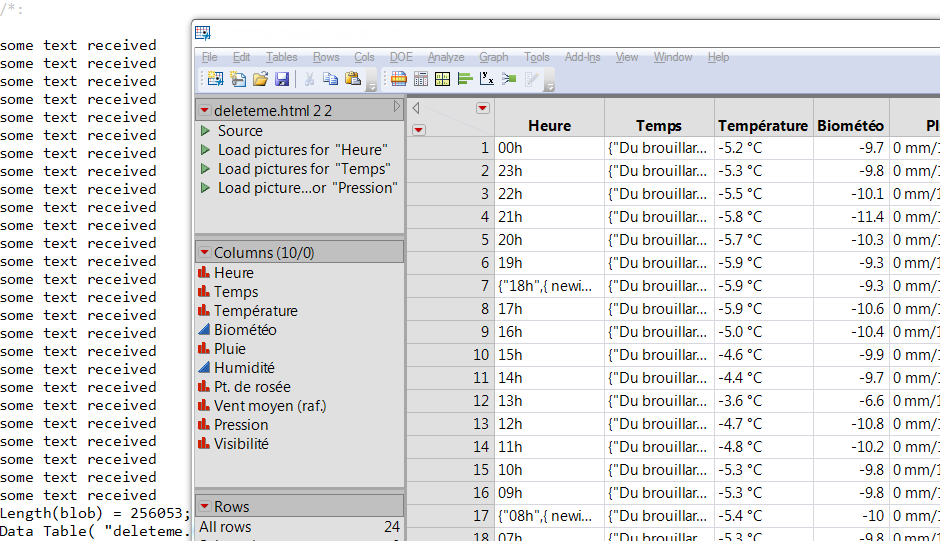

It looks like JMP on Windows does not handle IEC_8859-15 very well. Here's a work-around (the sockets will not work for https, only for http) if you need it. Mostly taken from the re-written scripting example in JMP 13.1. At the end, the page is imported with iso-8859-1; it appears to be close enough; the wikipedia page shows eight characters that might be problems.

// JMP does not understand what the page claims: iso-8859-15
txt = blobToChar(blob,encoding="iso-8859-1"); length(txt);
f = saveTextFile("$temp/deleteme.html",txt);
open(f,htmltable(2))
Imported tableImported table
