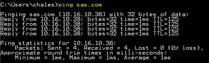

this script uses ping to get an echo back from a server; the text from ping might be a little different on various OS flavors and the test for "Received = 1" might need adjusting. n=1 means only ping once, w=100 means don't wait more than 100ms.  The mac version will be different, this is (barely) tested on windows.
Ping is named after the sound submarine sonars make...then listen for the echo. But unlike a real echo, other delays are possible with busy computers. Your ping might easily pass through five or more computers, and the echo will be similar.  You can play with ping in a "dos box" like this:
Using ping in a "dos box"Using ping in a "dos box"

Craige_Hales
Re: Files on network
try ping with the network disk; that is the middle example. I can't test it completely without asking someone to turn a drive off...
