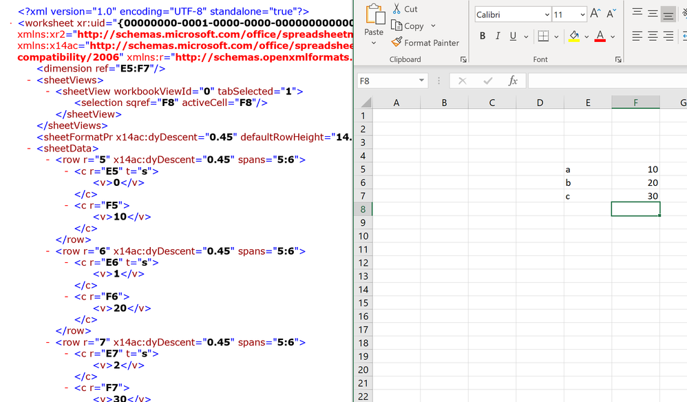

XLSX is just a zip file containing XML files.  You can use the XML to reference cell coordinates:
You can use ZipArchive to get to the XML files.
-Dave
