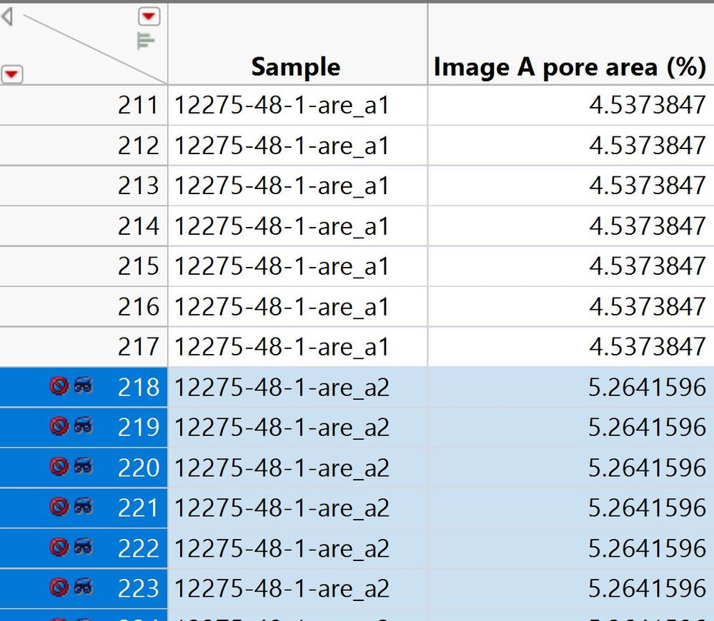

- I have a sample table that contains data sets for three replicates with sample suffix a1, a2, and a3.
- At times, one of the replicates needs to be set to the "Excluded" state (example below is a2)

Many thanks for the input. I'm still a bit of a novice, but took a stab at the Associative Array concept. Code is shown and will work up to "Get Keys". However, I'm still unsure how to grab the information that I need from "speciesmatches" to make the needed calculations (last 6 lines listed). I took an image of a typical table that would contain excluded sets.
