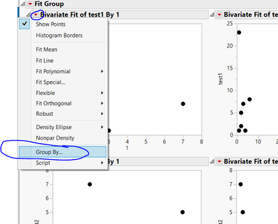

if i do it by hand its like this:
and then I pick by "Group" (I believe I need to add this to the script somehow)
then I click "flexible" --> "fit spline" --> mark the "standardize x" and click "ok"

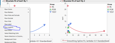

and last thing I add is row legend
