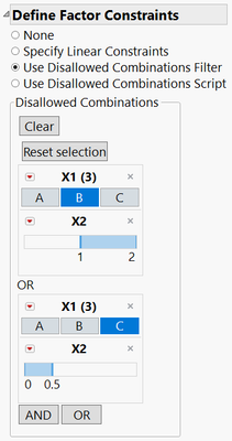

I set up a design with a categorical factor for ingredient (A, B, C) and a continuous factor for Amount (0 to 2).
Then I set up 2 disallowed combinations, as below. (I select OR after creating the first one)
For B, amounts between 1 and 2 are disallowed.
For C, amounts between 0 and 0.5 are disallowed.
You should find that the resulting design (attached)  obeys these constraints.
You can also use Disallowed Combinations Script to do the same things.
These are the same disallowed combinations defined in a script:
X1 == "B" & (X2 >= 1 & X2 <= 2) | X1 == "C" & (X2 >= 0 & X2 <= 0.5)

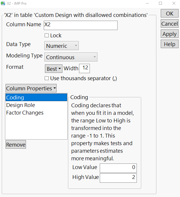

2. Remove the Coding column property from the X2 column in the design data table.

This is the column property to remove:

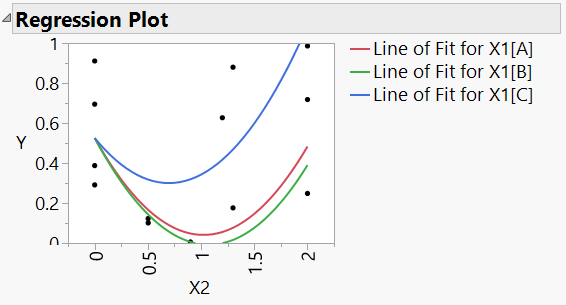

This is showing that the intercept of the model (where X2=0) is the same for all levels of X1, as it should be:
