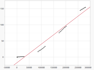

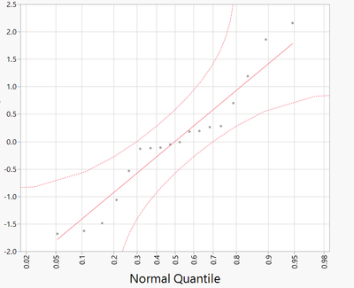

Hi,
I am looking for a way to identify which data points to include in my bivariate linear regression. The slope is increasing, then reaching a steady state and subsequently decreasing. I would like to use linear regression in the steady state phase and want to use statistics to determine which data points should be included in this i.e. when the steady state is reached and the residuals for the trendline are minimal. So far, I have fitted a line with different sets of data points and compared R2. However, there must be a smarter way to do this...
Looking forward to any advice :)

Cherry picking points to support a hypothesis in a data set like this is art at best. Plus after looking at the graph one could start an argument that with the gaps in the data, there is NO data at 'steady state', whatever that means. Slope = 0 vs Slope not equal to zero? At what alpha risk? The underlying process generating the data is at some 'steady state' that has an underlying physical/biological/socioeconomic basis? IMO too much unknown to answer the question on what basis to cherry pick points.

First, welcome to the community.  As usual, Pete's comments are right on.  I'll add some thoughts:
1. What is the intent of this exercise?  Is this a real situation or purely academic?  Why would you remove data form the data set?  You might be removing the most informative information.  How adequate is the measurement system?
2. What is your definition of "steady state"?  I don't see any steady state in the picture you attached.  I see what appears to be 3 groups of data with large gaps in the data.  There is a group that forms a fairly straight line, but without context, that is meaningless (and a really small data set at that).
3. If your question is what outlier tests could you do, there are many.  Which you use depends on how the data was acquired.  You could use time series tests, multivariate tests, residual plots, leverage plots, etc.
4. Realize R^2 is just one statistic.  Whether it is a good indicator of your models adequacy depends on how the data was acquired. A better use of R^2 in model building is the examine the delta between the R^2 and the R^2 adjusted.  Large deltas are indicators of over-specified models.  You might want to consider RMSE, p-values along with residuals plots.

First of all, thank you very much for your replies and i am very sorry that i can only respond now....

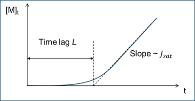

To provide some background, this is the theoretical graph we are expecting and the slope and time lag are the corresponding results.
In our experiment we are acquiring data points over the course of days and are expecting a slow increase in slope and then the reaching of steady state (i.e. only minor fluctuations in slope). Subsequently the slope will flatten as additional factors come into play. As these are real-time data points, sampling over night is not possible which results in gaps in the data points and as this setup is new we do not know whether steady state is reached at day one or day 5. Once this is more clear we will add additional sampling points in the area of interest. To find out about this i need to identify the timeframe when steady state is reached and this is what my question is relating to. So for example with this data set:

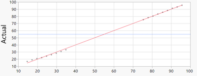

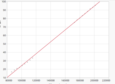

i can already see that the first and the last set of data points are not relevant so i am excluding these data points.

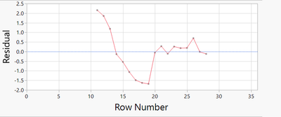

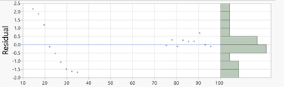

Looking at these data points that are left i am looking for a tool to decide which data points should be included as they contribute to the accuracy of the slope at steady state and additional effects before and after the steady state are excluded. For this i had so far created linear fits while excluding more and more data points and then looking at the R2. You mentioned looking at the residuals, is there a cutoff you would recommend? I will add the residual plots below.
RWils_3-1671196616829.pngRWils_4-1671196633300.pngRWils_5-1671196645896.pngRWils_6-1671196672867.png
Thanks again for your responses!

1. A starting point in t when the slope is constant (at some level of confidence)? Based on the theoretical graph, this point in t will be greater than the line extension back to the x axis.
2. A point in t that corresponds to the asymptote? The theoretical graph you posted seems to be doing this..

I am doing the experiments in order to get values for the slope and time lag described in the picture I had send. For this I need to find the data points where the slope is constant and then do linear regression to calculate the intercept with the x axis of this . I hope this makes it more clear?

The Fit Curve platform can both a) generate parameters for curves and b) show derivatives for the slope of the curve. In the example below, you could use the asymptote of 38.8 to indicate the end of the flat section/start of the upwards section. There are a bunch of assumptions going into this though, first of which is that you could find a curve that both fits your data and fits the theory of why your data is shaped the way it is.
I've attached a file with a script embedded as an example.
