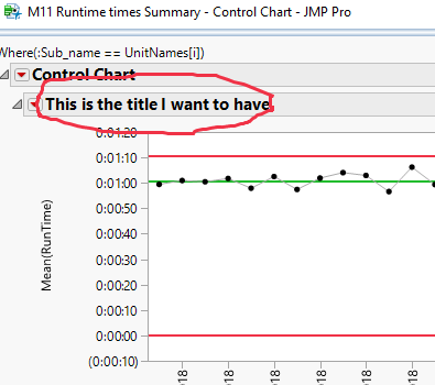

How do I change the name of the IR charts.  I produce about 16 to 20 charts in a vertical window.  When I create it from the table data they are all labeled with the Sub_name column value, but when I create it from the script they are labeled with "Control Chart" and "Individual Measurement of Mean(Runtime)".  I would like each chart to be labeled with the value in  UnitNames[i].

I will show you the changes necessary to do what you want, however, I will do it by showing you that you could figure this out all by yourself, because JMP will show you how to do this.
Your request is to change the name of the Outline Box that is created that repeats the title, "Individual Measurement of Mean(Runtime)".  So, the first step is to simply change that title in one of the outputs.
Then go to the red triangle and save the script for the changed chart
Control Chart(
	Sample Label( :Date ),
	Group Size( 1 ),
	KSigma( 3 ),
	Chart Col( :Name( "Mean(RunTime)" ), Individual Measurement( LCL( 0 ) ) ),
	Where( :Sub_name == UnitNames[i] ),
	SendToReport(
		Dispatch(
			"Individual Measurement of Mean(RunTime)",
			OutlineBox,
			{Set Title( "This is the title I want to have" )}
		Dispatch(
			{"Individual Measurement of Mean(RunTime)"},
			"2",
			ScaleBox,
			{Format( "hr:m:s", 13, 0 )}
		Dispatch(
			"Control Chart Limits frame",
			FrameBox,
			{Frame Size( 64, 208 )}
Note how JMP indicated how to change the chart to make the Outline Box title a different name
Dispatch(
			OutlineBox,
Now all you have to do, is to reincorporate this change back into your script, and substitute the title for the UnitNames[i], which is your list entries for your requested Sub_name
