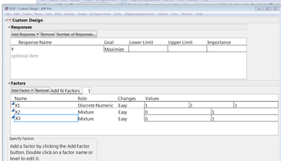

Hello,
Here is one option for you.  You can use the Custom Design platform under DOE to designate the factor types you want for your Mixture Design.  Below is an example of a 3 level discrete factor and two mixture factors.  You can have upwards of 8 different levels for your discrete factor.
If on the the other hand you want keep one factor as a constant amount in the mixture and vary the others from low to high you can use a mixture sum to limit the mixture components to specified percentage and use the constant amount to make up the difference.
Hope this helps.

Hello billw,
thank you very much for your instant help. However, I did try this solution before but when doing it like this, I can't add constraints of mixture for all three factors. Since one factore is not flagged as "mixture" but as "discrete numeric" it will not be considered in the mixing rules by jmp. Do you have an idea, what my mistake might be?
Thank you again in advance!

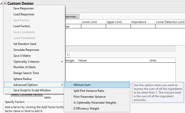

Hi Bill,
Where can I find the mixture sum on Jmp17?
Thank you,
Gwenn
Re: I would like to set a mixture design (DOE) with one factor being discrete in JMP. How is that possible?
Same place as before:
