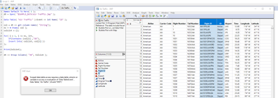

I need to group columns using contain function of column name.
I am trying to group a Column by a contain function of column name. I need to group every column that contain "ID". Here is what I came up with. What am I doing wrong?
<JSL>
Names Default To Here( 1 );
dt = Open( "$SAMPLE_DATA\Air Traffic.jmp" );
Data Table( "Air Traffic" ):Event << Set Name( "ID" );
col = dt << get column names( "String");
nc = N Items( col );
colList = {};
For( i = 1, i <= nc, i++,
If(Contains (col[i] ,"ID"),
Insert Into( colList, col[i] ))
Print(ColList);
dt << Group Columns( "ID", ColList );

At least JMP won't like that you have same name for column and group
Names Default To Here(1);
dt = Open("$SAMPLE_DATA\Air Traffic.jmp");
Column(dt, "Event") << Set Name("ID");
colnames = dt << get column names("String");
idcols = Filter Each({colname}, colnames, Contains(colname, "ID"));
dt << Group Columns("ID_GROUP", idcols);
-Jarmo

Re: I need to group columns using contain function of column name.
Thanks Jarmo,
As usual you are a life saver. Thanks for the alternative solution.
