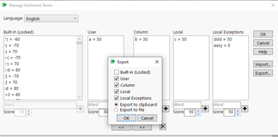

I have edited the sentiment term list. How do I export it from the Manage Sentiment window?
I spent an afternoon editing the sentiment list for a specific application. I have a longish list of new sentiment concepts and scores. There is an Export button on the Manage Sentiment screen, but whichever of the destinations I chose, nothing is exported.  I have done this with no terms marked and with all my new terms marked.

Have you checked if documentation can help you,  Basic Analysis > Text Explorer > Text Explorer Platform Options > Text Preparation Options . Have you selected what you wish to export?
I did very quick test and managed to export values to clipboard at least
a	50
b	50
c	50
ddd	50
easy	0
