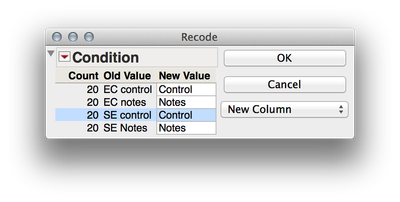

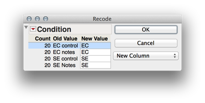

2. We need to separate out the levels of your two factors  (Ec vs Se  and notes vs controls) if we wish to analyze these factorially. We can accomplish this by twice using Cols > Recode to create two new variables. First select the "Condition" column in the dataset and then select Cols > Recode. Here are the screen shots of the recoding I did, and be sure to select "New Column" rater than "In Place" for the new column (otherwise values will be written over).  What these will do is create two new columns that have the levels of each factor independently. This is important when we define the mixed model later.
7220_Screen Shot 2014-09-07 at 12.57.50 AM.png7274_Screen Shot 2014-09-12 at 6.39.48 PM.png
3. Rename the two new columns to have reasonable names. I'm using bacterial strain and surface.
