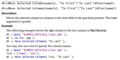

Well, kind of.  I tried them, because it can take a list of columns.  In this case, it seems to want even a single column in list format.
jthi
Re: I cant move newly created columns to specific locations
You might find syntax information sometimes from JMP Help Scripting Guide > Data Tables > Work with Columns > Rearrange and Move Columns or JSL Syntax Reference (can be found from JMP Documentation page)
