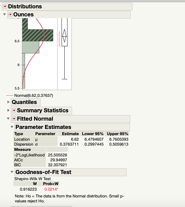

According to candy data from tutorial, it is not normal from first picture below. Then we should go to median test instead of mean test.

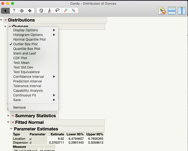

At this moment, I cannot see median test in the command (follow 2nd picture). Please advise whether I miss it or there are no median test any more at this moment.

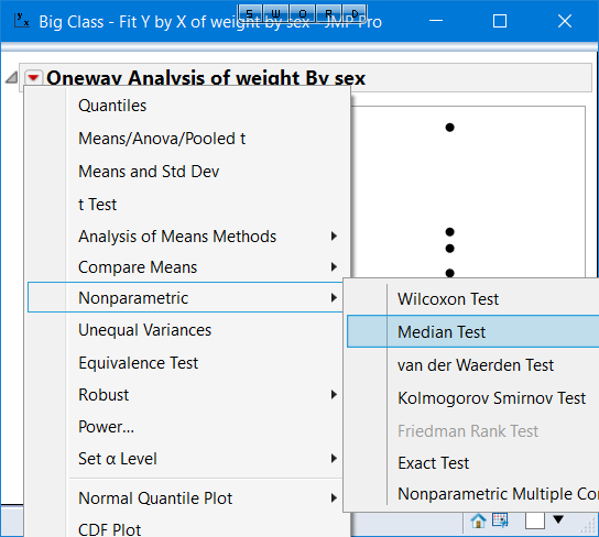

If you are using Fit Y by X, with continuous Ys and nominal X, a Oneway Analysis window is created. Then select the red menu, Robust, Median test.  Or select Main Menu, Statistics Index and scroll down to median test to find an example.

Please help to clarify whether my analyse step is correct or not. I use one mean tutorial and Candy jmp file.
1. I plot distribution to find out whether it is normal distribution or not.
2. Select continuous fit ==> Normal
3. From fit normal red triangle ==> select goodness of fit
4. From note: Ho = The data is from normal distribution. Small p-value reject Ho. This mean data is not normal distribution.
From tutorial, they use test mean to verify. But this data is not normal distribution. We should use test median instead of test mean.
Question: Please confirm my understanding above correct or not. This is what I learnt many year ago.
If my understanding correct. Can I get test median from red triangle of histogram or not. If not, how can I get it.

To do a test on the median, click on the red triangle menu next to Distribution (in the platform output) and choose Test Mean. Check the Wilcoxon Signed Rank box, enter the value you want to test, and click OK. The Signed-Rank test statistic is given, which tests the null hypothesis that the median equals the postulated value. It assumes that the distribution is symmetric.
