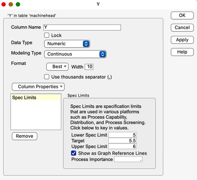

There may be other ways, as Jarmo indicates you can add spec limits to the properties of the column
Screenshot 2023-08-13 at 8.49.39 AM.pngScreenshot 2023-08-13 at 8.49.39 AM.png

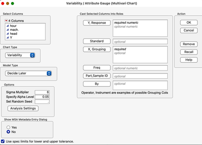

Then when you create the Variability plot, check the box at the bottom:
Screenshot 2023-08-13 at 8.49.58 AM.pngScreenshot 2023-08-13 at 8.49.58 AM.png
