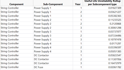

I am trying to figure out how to multiply the unreliability of all the sub-components per year.
I was thinking of creating an array for each year and use "Product" function to multiply all of the element within the array. But I feel like it will be loop within loops. Is there any suggestion to achieve this task?

the question you are asking should have been very simple to answer if only the tables>> summary platform or the Analyse >> tabulate procedure would have "Product" as an option.
meanwhile the way i would do it is as follows:
first split the table by year and group by subcomponent. then product is available as an option in formula for a new column.
